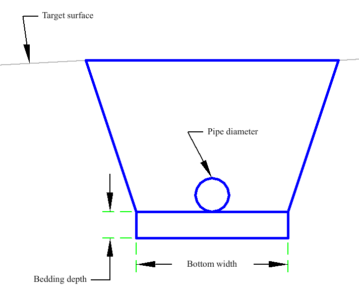

PipeTrenchAdjustDiameter
The PipeTrenchAdjustDiameter subassembly with a single pipe in a trench that allows volume calculation of bedding base and granular backfill.
The depth will vary in the section of Granular Backfill; the others will be a constant. All of the depths, widths, and diameters will change from trench to trench. The depth of the trench will vary along the alignment since it is measured from the bottom of the trench to the target surface. The excavation sides will be vertical for depths less than 12' (3.5 m) and sloped at 300% for depths greater than that. The profile will follow the center of the pipe.

Bottom Width Bottom Width of the pipe trench Numeric, positive
3 ft
1 m
Pipe Cover Depth of the trench from the top of the pipe to the surface Numeric, positive
0.5 ft
0.15 m
Pipe Diameter Pipe diameter Numeric, positive
0.667 ft
0.2 m
Bedding Depth Depth of the pipe bedding over trench bottom Numeric, positive
0.166 ft
0.05 m

Behavior
The level of the bottom of the trench is calculated as the profile gradient line level minus one half the pipe diameter plus bedding depth. The horizontal trench bottom link is placed symmetrically about the attachment point offset at that level. If the depth of the trench is less than 12' (3.5m), the sides of the trench are vertical. Over this depth, the trench has 300% side slopes. In both cases the side slopes are extended upward to the existing surface.
Layout Mode Operation
In layout mode, this subassembly draws a trench.

P1 PipeBottom Bottom of pipe
P2 BeddingBottomCenter Bottom center of bedding
P3 PipeBackfillBottom_In Inside pipe bottom of backfill
P4 PipeBeddingBottom_In Inside pipe bottom of bedding
P6 PipeBeddingBottom, Datum Pipe bedding bottom
P7 PipeBackfillBottom_Out Outside pipe bottom of backfill
P9 Hinge, Top
P10 Top
P11 Pipe
P12 PipeTop Top of pipe
P13 Pipe
P14 PipeCentre Center of pipe
L1, L5 PipeBackfillBottom Pipe backfill bottom
L2,L4 PipeBedding Pipe bedding
L3 PipeBeddingBottom, Datum Pipe bedding bottom
L6 - L7 Pipe
L8 TrenchSlopeInner Inner pipe trench slope
L9 TrenchSlopeOuter Outer pipe trench slope
L10 Top
S1 PipeBedding Pipe bedding
S2 TrenchMaterial Trench backfill material
Coding Diagram
