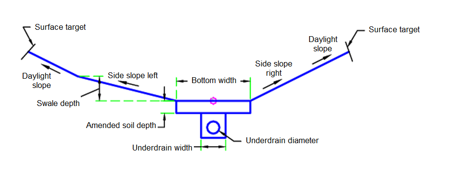

VegetatedSwale
The VegetatedSwale subassembly creates a vegetated swale to treat storm water.
The attachment point is at the middle top of the vegetated swale.
Input Parameters
Note: Note: All dimensions are in metres or feet unless otherwise noted. All slopes are in run-over-rise form (for example, 4 : 1) unless indicated as a percent slope with a “%” sign.
Parameter
Description
Type
Default
Side Specifies which side to place the subassembly. Left / Right Right
Bottom Width Swale bottom width Numeric, positive 3
Include Amended Soil Include amended soil under swale Yes / No Yes
Daylight Slope Daylight slope Numeric, positive 2 ( : 1 )
Amended Soil Depth Depth of amended soil Numeric, positive
0.5 ft
0.15 m
Underdrain Diameter Diameter of underdrain Numeric, positive
0.5 ft
0.15 m
Underdrain Depth Depth of underdrain Numeric, positive
1 ft
0.30 m
Underdrain Width Width of underdrain Numeric, positive
1 ft
0.30 m
Include underdrain Include underdrain Yes / No Yes
Swale Depth Depth of swale Numeric, positive
1 ft
0.30 m
Side Slope Left Left side slope Numeric, positive 4 ( : 1 )
Side Slope Right Right side slope Numeric, positive 2 ( : 1 )
Target Parameters
This section lists the parameters in this subassembly that can be mapped to one or more target objects. For more information, see To Specify Corridor Targets.
Parameter
Description
Status
Surface Target Name of the daylighting surface. The following object types can be used as targets for specifying the surface: surfaces. Optional
Runtime Logical Assignments
None.
Output Parameters
None.
Behavior
Starting at the attachment point, the swale is built using the input parameters. If the surface target is set, the daylight surface is found (only for cut situations). If include underdrain is set to Yes, then the underdrain is built.
Layout Mode Operation
In layout mode, the vegetated swale is built.
Point, Link and Shape Codes
The following table lists the point, link and shape codes for this subassembly that have codes assigned to them. Point, link or shape codes for this subassembly that do not have codes assigned are not included in this table.
Point, Link or Shape
Code
Description
P1 Flowline Flowline of the vegetated swale
P2, P3 Swale Edge of swale
P4, P5 Hinge
P6, P7 Daylight, Daylight_Cut
P10-P13 Underdrain
P14 Pipe_Invert Invert of underdrain pipe
L1 - L4 Swale, Top Top of swale
L5, L6 Daylight, Daylight_Cut
L9 AmendedSoil, Datum Bottom of amended soil
L14 Underdrain, Datum Bottom of underdrain
S1 AmendedSoil
S2 Underdrain
Coding Diagram
