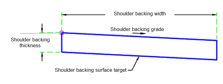

ShoulderBacking
The ShoulderBacking subassembly inserts links and shapes to create a shape to represent shoulder backing.
The attachment point is at the inside edge of the shoulder backing. This component can be attached to either the left or right side.

Behavior
The initial point is set at the attachment point. The initial shoulder backing sides and top are constructed from the input parameters. The bottom inside and outside point levels are checked against the target surface to determine if the point is in the cut or fill condition. If both are in, the bottom link is created at a matching gradient of the top link.
If in fill, the shoulder backing bottom is extended to the surface target.
Layout Mode Operation
In layout mode, this subassembly draws the shoulder backing using the input parameters.
Point, Link and Shape Codes
The following table lists the point, link and shape codes for this subassembly that have codes assigned to them. Point, link or shape codes for this subassembly that do not have codes assigned are not included in this table.
Point, Link or Shape
Code
Description
P1, P2 Backing Shoulder backing
P3, P4 Backing_Sub Bottom of shoulder backing
L1 Top, Backing Top of shoulder backing
L3 Datum Bottom of shoulder backing
S1 Backing Shoulder backing area
Coding Diagram
