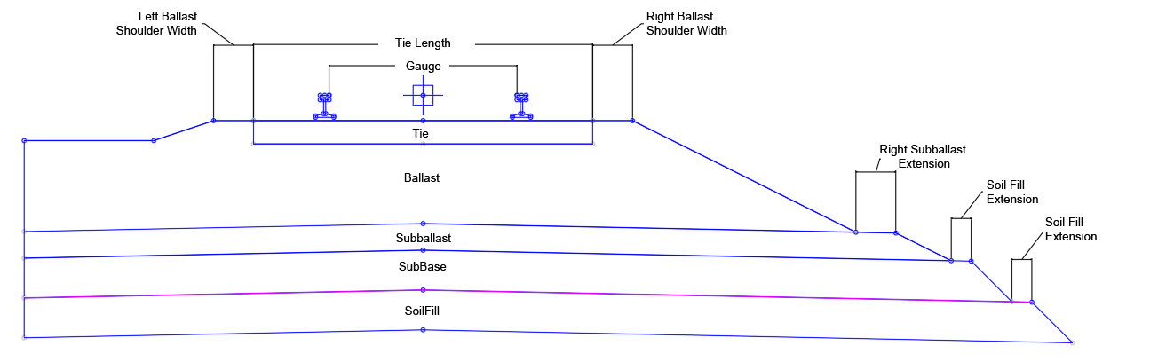

Right_Hand_Multi_Track
The Right_Hand_Multi_Track subassembly is used for a single railroad that includes sleepers, ballast, subballast and two additional layers or materials which can be used for Sub Base and Soil Fill material.
The dimensions of the Right_Hand_Multi_Track rails can be edited as well as the dimensions of the material layers.
Note: For this subassembly, the left side elevation should be lower than the top of the ballast. If the left side elevation is higher than the top of ballast, the result will be incorrect. If you need this subassembly to behave differently, you can use the Subassembly Composer to modify the existing PKT file to suit your needs. Subassembly PKT files are located in C:\ProgramData\Autodesk\C3D <version>\enu\Subassemblies\<unit>.
By default, the attachment point is at the centreline between the rails. The track can be moved relative to this point using the subassembly parameters.

This subassembly works in multi-track situations in conjunction with the Internal Multi track Subassembly and/or the Left Hand Multi Track Subassembly. With these subassemblies, each rail line has its own alignment and profile. Place this subassembly internally to the right hand alignment and profile. Control the left edge location of the subassembly with the input parameters or with the target parameters provided. Target lines between the right hand alignment and the internal rail alignment.
When you apply rail cant information to the alignment baseline, the rails rotate accordingly. The point about which they rotate depends on the Pivot Method setting contained in the cant information for the alignment. If you set a Pivot Method to Low Side Rail, then the rail on the inside of the curve is held at track level and the level of the outside rail is adjusted an amount equal to the cant value.
If you set the Pivot Method to High Side Rail, then the rail on the outside of the curve is held at track level and the level of the inside rail is adjusted an amount equal to the cant value.
If you set the Pivot Method to Centre Baseline, then both rails are adjusted an amount equal to half the cant value, the outside rail upward and inside rail downward.
The Minimum Ballast Depth value applies at the location of the minimum clearance between the tie and subballast. The Subballast Top Slope parameter independently controls the subballast top slope . The Baseline to Subballast Crown parameter controls the location of the subballast crown.

Coding Diagram
