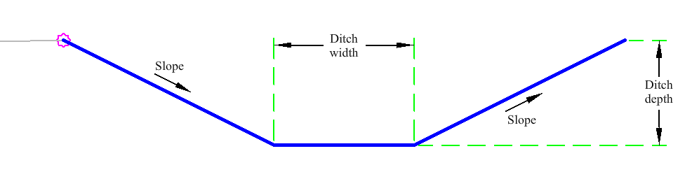

The EvenSlopeDitch subassembly creates a ditch to add to either the left or the right sides of the assembly.
The attachment point is at the inside edge of the first link.

Side
Specifies which side to place the subassembly. Left/Right
Right
Ditch Depth
The depth of the bottom of the ditch from the attachment point to the bottom of the foreslope link. Numeric, positive
3 ft
1 m
Slopes
The slope of the sides of the ditch. Numeric, positive
2 (: 1)
Ditch Width
Width of the ditch. Numeric, positive
2 ft
0.6 m

Behavior
The subassembly builds the shape for a ditch using the input parameters.
Layout Mode Operation
In layout mode the subassembly displays the links comprising the ditch using the input parameters.

P1 Hinge, Top Hinge point
P2 Ditch_In, Bottom_Ditch Bottom inside of ditch
P3 Ditch_Out, Bottom_Ditch Bottom outside of ditch
P4 Hinge
L1 Top, Datum, Ditch, Foreslope, Slopes Foreslope
L2 Top, Datum, Ditch Bottom ditch
L3 Top, Datum, Ditch, Backslope Backslope
Coding Diagram
