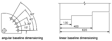

Creates a linear, angular, or ordinate dimension from the baseline of the previous or selected dimension.
Tool Set:
Menu: .
The default spacing between baseline dimensions can be set from the Dimension Style Manager, Lines tab, Baseline Spacing (DIMDLI system variable).
If no dimension was created in the current session, you are prompted to select a linear, ordinate, or angular dimension to use as the base for the baseline dimension.
The following prompts are displayed.
Select base dimension: Select a linear, ordinate, or angular dimension
Otherwise, the program skips this prompt and uses the dimension object that was last created in the current session. If the base dimension is linear or angular, the following prompt is displayed:
Specify a second extension line origin or [Undo/Select] <Select>: Specify a point, enter an option, or press Enter to select a base dimension
If the base dimension is ordinate, the following prompt is displayed:
Specify feature location or [Undo/Select] <Select>:
To end the command, press Enter twice, or press Esc. The current dimension style determines the appearance of the text.
By default, the first extension line of the base dimension is used as the extension line origin for the baseline dimension. To override this default behavior, explicitly select the base dimension; the extension line origin becomes the extension line of the base dimension closest to the pick point of the selection. When you select a second point, the baseline dimension is drawn and the Specify a Second Extension Line Origin prompt is redisplayed. To end the command, press Esc. To select another linear, ordinate, or angular dimension to use as the basis for the baseline dimension, press Enter.
Uses the endpoint of the base dimension as the endpoint for the baseline dimension; you are prompted for the next feature location. When you select a feature location, the baseline dimension is drawn and the Specify Feature Location prompt is redisplayed. To select another linear, ordinate, or angular dimension to use as the basis for the baseline dimension, press Enter.
Undoes the last baseline dimension entered during this command session.
Prompts you to select a linear, ordinate, or angular dimension to use as the base for the baseline dimension.
