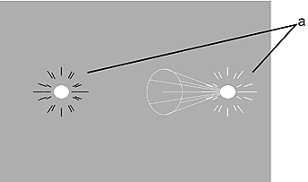

The light icon appears in the scene.
(a) Light sources in the scene.
