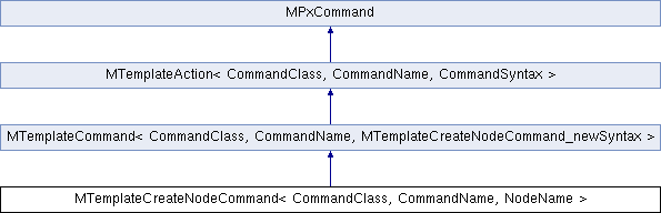

C++ API Reference
Template class for undoable commands to create/delete a node. More...
#include <MTemplateCommand.h>
Helper template class which make it easier to write commands to create/delete a node.
The command is tied into an MDGModifier to create a node with undo support.
