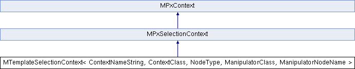

template<const char * ContextNameString, class ContextClass, MFn::Type NodeType, class ManipulatorClass, const char * ManipulatorNodeName>
class MTemplateSelectionContext< ContextNameString, ContextClass, NodeType, ManipulatorClass, ManipulatorNodeName >
Template class for selection context.
Template helper to build selection contexts.
- Parameters:
- ContextNameString : string name of context command
- ContextClass : context command derived from MPxContextCommand
- NodeType : MFn type that selection context should operate on
- ManipulatorClass : derived from MPxManipulatorNode
- ManipulatorNodeName : name of the manipulator node
- Examples:
- lineManipContainer/lineManipContainer.cpp, and squareScaleManipContext/squareScaleManipContext.cpp.
