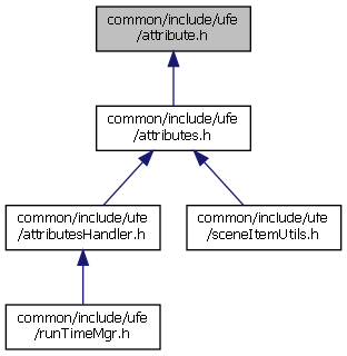

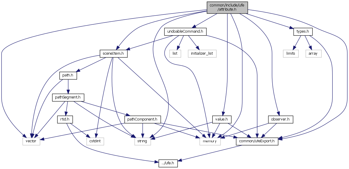

#include "common/ufeExport.h"#include "sceneItem.h"#include "observer.h"#include "types.h"#include "undoableCommand.h"#include "value.h"#include <memory>#include <vector>#include <string>
Go to the source code of this file.
