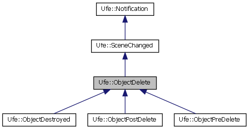

Universal Front End is a DCC-agnostic component that will allow a DCC to browse and edit data in multiple data models
Base class for object delete scene notifications. More...
#include <sceneNotification.h>
This class is the base class for object delete scene notifications. There are three ObjectDelete derived class notification types: post-delete, pre-delete and destroyed. This covers runtimes that send notification just before the object is deleted (e.g. Maya), and those that send notification just after the object is deleted (e.g. USD).
