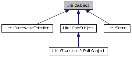

Observer pattern Subject class.
This class implements the Subject in the Observer Pattern:
https://en.wikipedia.org/wiki/Observer_pattern
Observers are held by weak pointer. The order in which observers are notified is unspecified, implementation dependent, and can change at any time. Observers should NOT rely on the order in which they are added to a Subject and assume they will be called in the same order.
The semantics of Subject under copy, assignment, move, and move assignment are that observers are not copied or moved. As compared to preventing copying, this provides flexibility for derived classes to support the value-based semantics of copy, as well as efficient support of temporary objects with move.
