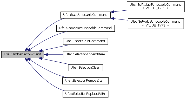

Abstract base class for undoable commands.
This base class defines the trivial interface to implement the Command pattern
https://en.wikipedia.org/wiki/Command_pattern
for interactive multi-level undo.
Definition at line 32 of file undoableCommand.h.

virtual |
Initial execution of the command, which should be called exactly once. Implementation in this class calls redo().
Reimplemented in Ufe::CompositeUndoableCommand.
