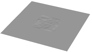

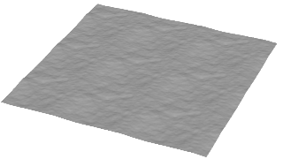

- Periodic
- Repeats the wave pattern in space. This lets you use a smaller patch to deform a larger mesh plane, but the repetition of the tile may be noticeable.
Periodic on versus off
