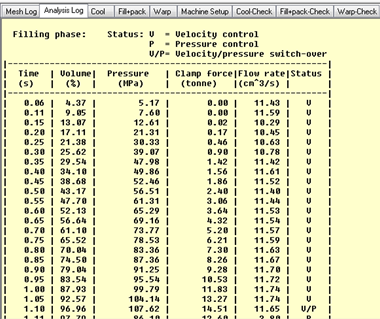

Analysis progress table
This section includes an analysis progress table, which provides tabular results for each time-step in the analysis. During the filling phase you can see the relation of volume of cavity filled, pressure inside the cavity, clamp force, and flow rate to analysis times. During the packing phase the percent of cavity packed over time is reported.
Note: In the case of an Injection-compression analysis, the %Volume value is based on the final cavity thickness when the mold is closed. The %Volume value can therefore exceed 100% before press compression commences.
