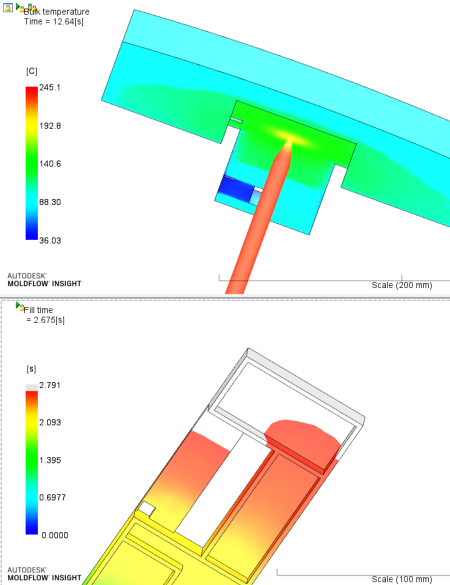

Select the Bulk temperature result from the Study Tasks pane.
Click ( Results tab > Animation panel > Play). A simulation of the bulk temperature is displayed. Note how the cooling of the part after filling is best represented with an animation. The hot runner is also shown to retain most of its heat as expected.
Select the Fill time result and view an animation of the fill time.

Click (View tab > Locking panel > Lock Animation).
Click (View tab > Windows panel > Split > Split Horizontally).
Click in the lower window to make it active and select the Fill time result from the study tasks pane.
Rotate the model to -170 -25 55 and zoom in on the tail of the model.
Click (Results tab > Animation panel > Play).
Click Step Backward twice, and click
Step Forward once.
The difference in time for the extremities of the model to be filled is illustrated. This could cause overpacking in the first section that is filled.
