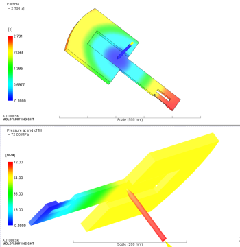

    View multiple results:
  10. Click split horizontal icon (View tab > Windows panel > Split > Split Horizontally). The screen is split and a duplicate of the model is displayed in the lower portion of the screen.
    The split pane tools work as a toggle. Use the tool to turn the splits on and off. Turning a split off removes any specific formatting settings for that pane.
    Note: The dotted line inside the a pane indicates the active pane.
  11. Click inside the lower pane. This is now the active pane.
  12. Select Pressure at end of fill from the Results section of the Study Tasks pane.
    Note: The analysis result type is displayed in each model pane.
  13. Rotate and zoom in on a section of the model and note how the image in the upper pane has not altered. This allows you to view different results in different parts of the model.
    split screen
  14. With the bottom pane still active, select Fill time from the Results section of the Study Tasks pane. This allows you to view the same result in different parts of the model.
  15. To synchronized views, click split vertical icon (View tab > Windows panel > Split > Split Vertically). You should now have four panes showing.

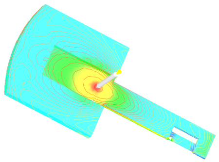

    Alter display method and overlay results:
    Results such as Volumetric shrinkage at ejection and Bulk temperature at end of fill , which are normally represented by solid shaded colors, cannot be overlayed.
  43. Select Bulk temperature at end of fill . Right-click on the name in the Study Tasks pane and select Properties from the menu that appears.
    The Plot Properties dialog appears. This dialog will be discussed in a later task.
  44. Select the Methods tab from the top of the dialog.
  45. Select the Contour option.
  46. Enter 50 in the Number of contours text box and click OK.
    The results are displayed in contours.
  47. Right-click on Volumetric shrinkage at ejection and select Overlay. Rotate the model to investigate the result.
    overlauy
    Note: The scale range on the right of the Model pane represents the Volumetric shrinkage at ejection result. Right-click on Bulk temperature at end of fill in the Study Task pane and select Activate to display this value range.
