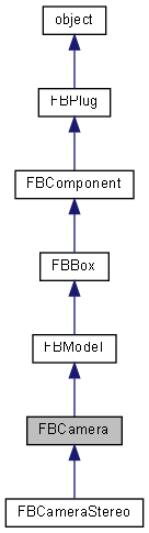

Creates custom cameras and manages system cameras. More...
Public Member Functions | |
| FBCamera (str pName) | |
| Constructor. More... | |
| GetCameraMatrix (FBMatrix pMatrix, FBCameraMatrixType pType, FBEvaluateInfo pEvalInfo=None) | |
| Obtains the camera's matrix. More... | |
| FBVector4d | InverseProjection (int pX, int pY, float pDistanceFromCamera, bool pRelativeToViewport=False) |
| Returns the world coordinates based on screen coordinates and input distance from the camera. More... | |
