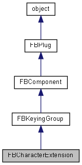

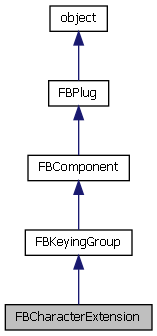

Inheritance diagram for FBCharacterExtension:
