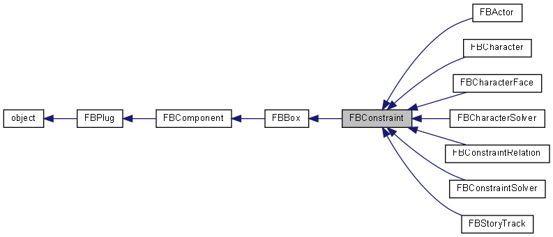

Inheritance diagram for FBConstraint:

Base class for constraints.
