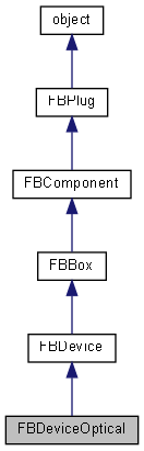

Optical device class. More...
| FBDeviceOptical | ( | str | pName | ) |
Constructor.
| pName | Unique name of optical device. |
