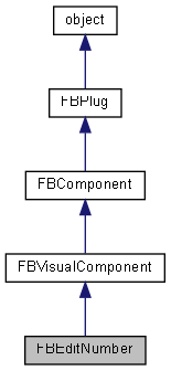

Number edit box. More...
Public Member Functions | |
FBEditNumber () | |
Constructor. More... | |
FBVisualComponent () | |
