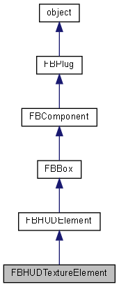

Heads Up display.
Texture HUD element. Display a texture on a rectangle on the HUD.
| FBHUDTextureElement | ( | str | pName | ) |
Constructor.
| pName | Name of new HUD texture element. |
| FBListTexture Texture |
Read Write Property: Texture to display.
