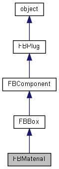

Material class. More...

Public Member Functions inherited from FBBox | |

Public Member Functions inherited from FBComponent | |

Material class.
See samples: MaterialAndTexture.py, TextureAnimation.py, VideoInput.py, VideoMemory.py.
