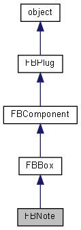

Note class. More...
Public Member Functions | |
| FBNote (str pName) | |
| Constructor. More... | |
| bool | Attach (FBComponent pComp=None) |
| Attach the note to a component. More... | |
| bool | Detach (FBComponent pComp=None) |
| Detach the note from a component. More... | |

Note class.
