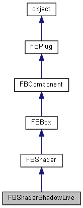

Inheritance diagram for FBShaderShadowLive:
