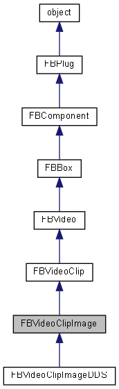

Video clip image media class.
Used for a variety of image types. For DDS images, use the FBVideoClipImageDDS instead.
