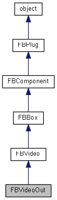

Video media class. More...
Public Member Functions | |
FBVideoOut () | |
Constructor. More... | |
FBVideo (str pName) | |
FBBox (str pName) | |
