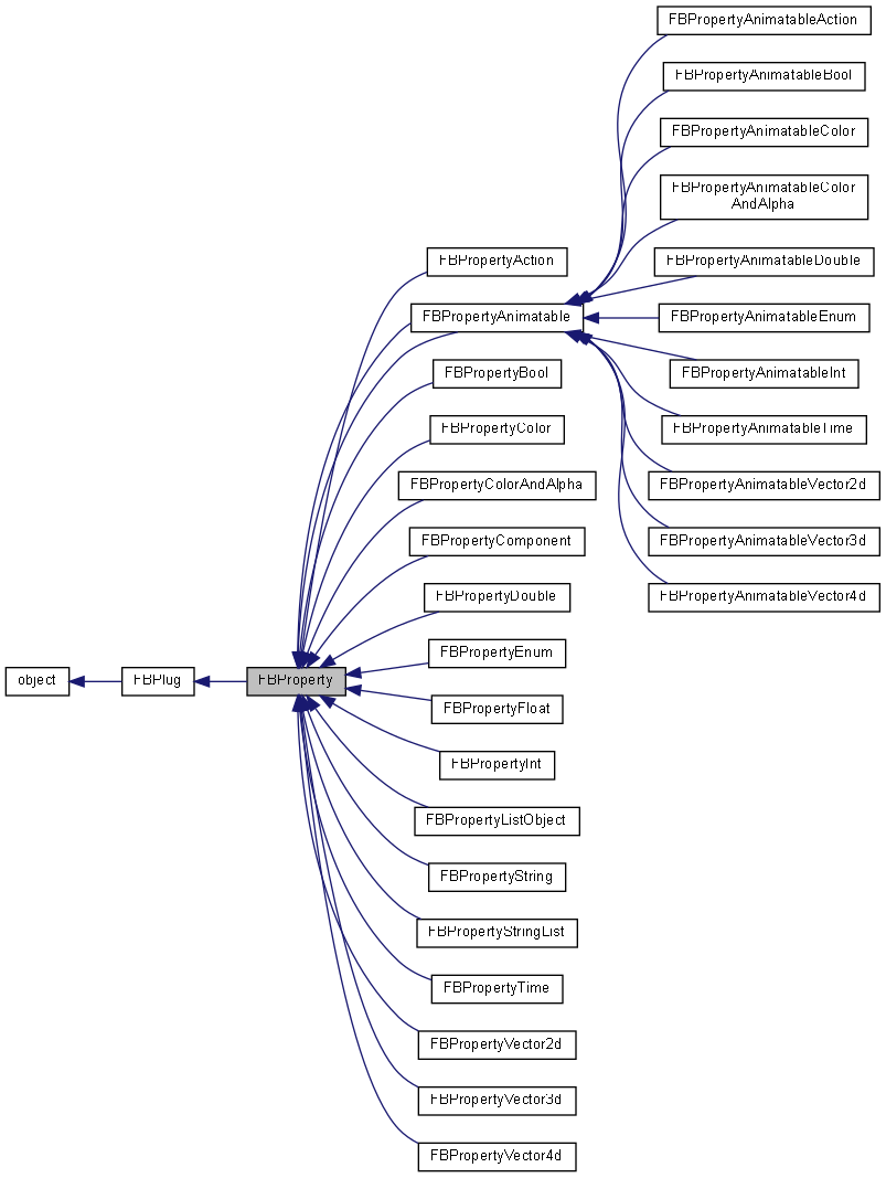

Generic application property. More...
Public Member Functions | |
| FBProperty () | |
b>Property: Action Action property to trigger function.
FBProperty objects cannot be instantiated by the user. Reference to a property can be obtained either via an instance of a FBComponent object, or by calling the method 'Find()' of a FBPropertyManager. The class FBComponent has a FBPropertyManager data member named 'PropertyList'.
When accessing a FBProperty object via its containing object, you can get or set (assuming it is not read-only) its value directly:
lObject.Visibility = True
When accessing a property reference directly, its value is obtained via it's 'Data' member.
lProp = lObject.PropertyList.Find( 'Visibility' )
if lProp: lProp.Data = True
The methods 'PropertyCreate()' and 'PropertyRemove' of the class FBComponent can be used to modify an object's set of properties.
