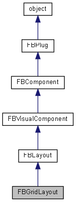

More advance layout that allow organisation of control in a grid. More...

Public Member Functions inherited from FBLayout | |

Public Member Functions inherited from FBVisualComponent | |

Public Member Functions inherited from FBComponent | |
