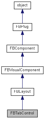

A real FBTabControl that improve the behavior of the FBTabPanel. More...
This class manage the Tabs and the 'middle region' used to display. It manages all the region 'swapping' necessary to implement a Tab behavior. - Use Add method to Add a Control to the FBTabControl. This will create a tab and ensure that when that tab is clicked the Control is shown. - Use SetContent with a tab index To specify which tab should be displayed.
