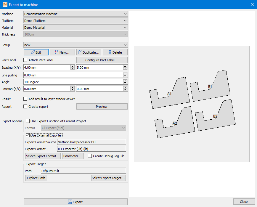

Export dialog
Machine Select the machine for which to prepare the test build
Platform Select one from the list of platform configurations
Material Select one from the list of materials
Thickness Select one from the list of layer thicknesses
Setup
Select a setup from the list of available setups. Use the buttons Edit, New and Delete to manage the list of setups. (See Setup dialog section below.)
A setup is a two-dimensional array of test part copies where individual buildstyle settings can be assigned to each part.
Part label Optional. Apply a label to the up-facing area of the build part. The text of the part label for each build part is controlled by the selected setup. Use the Configure part label to configure the size, position, rotation, and style of the part label. (See Part labeling – Test build parts section below.)
Spacing Configure the distance between build parts on the platform in x and y.
Line Pulling Each row is shifted sideways by the given value.
Angle The whole grid of parts is rotated by the given angle.
Position The whole grid of parts is shifted in x and y by the given values.
Result Independent from the file export, the calculation result can optionally be copied to the layer stacks viewer for detailed inspection.
Create report A report document can be created in addition to the exported file. This is a PDF document containing an image of the test platform and a list of all parameter variations. Clicking Preview generates and opens this report immediately.
Export options
An export routine must be selected here which is then generating the export file. If the current buildstyle project has implemented any export options, then these will be available for selection.
Alternatively, an external export routine can be selected which may be provided by an exporter module (usually a DLL).
Export Triggers the platform calculation and file export. This may take a while to execute, depending on the size of the test.
(Platform overview) Visualizes arrangement, orientation, and identity (A1, A2, …) of the generated part duplicates

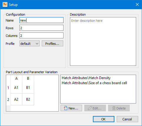

Setup dialog
In the export dialog, click Setup > Edit to open the Setup dialog.
Name Name of the setup under which it appears in the dropdown in the Export dialog
Rows, Columns Count of rows and columns to make up the grid of test parts
Profile Choosing a profile initializes all settings with its stored values. All configured parameter variations then override these defaults.

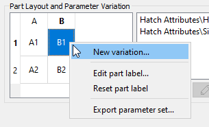

Part layout and parameter variation
A simplified visualization of the generated grid of test parts with their identities as used in the main export dialog. Right-click a cell to create or adjust the parameter variation. (See Part labeling – Parameter variation section below for the dialog to set up the naming template.)
With Export parameter set, a cell's variation is exported in JSON format.
To the right, any parameters with defined variations are listed.
New, Edit, Delete Replicates the right-click menu functions

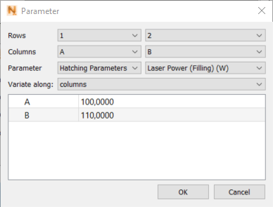

Parameters
In the parameter dialog you configure the rows and columns across which the parameter variation are to be applied.
Note: Platform-related buildstyle parameters cannot be configured part-by-part. Those values are set by editing the underlying parameter profile.
Rows, Columns Configure the range of part duplicates across which to apply the variation
Parameter Choose from the categories and the parameters within those categories to select which parameter to actually variate .
Variate along Determines the direction of variation
(Table listing) Provides insight into what variations are set up

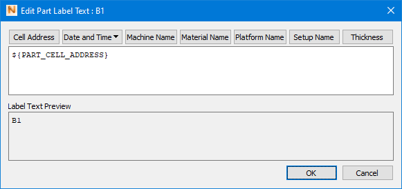

With this function you set up a template for the generation of naming strings. Use the buttons along the top to insert variables, and adjust the text by typing in the field below manually. With the preview you can verify whether your template string is working.

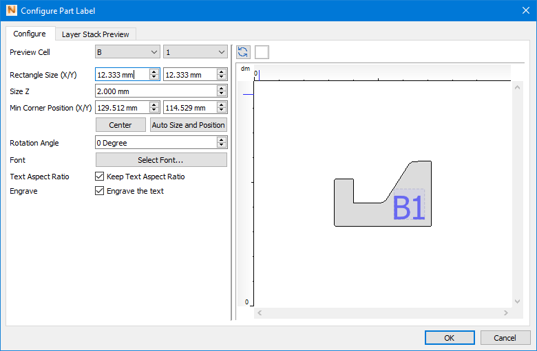

With this function you specify where the naming strings should physically appear on the respective parts.
