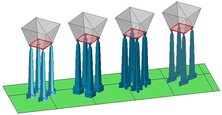

The type of cross-section for bars
From left: Cross, solid bar, solid cross, hatch (open hatch tube not shown)
Cross and Hatch have no enclosed volume, so their cross sections are rendered by single beam passes. This makes them fast to trace but also comparatively weak if used in larger sizes and lower numbers per area unit.
Solid bar and Solid cross have enclosed volumes but require toolpathing for their interior, and in particular can produce intersections that can lead to multiple exposure if not merged properly.
Open hatch tube is identical to Solid bar except that it is explicitly handled as open support by slicing.
  • Cross
  • Solid bar
  • Solid cross
  • Hatch
  • Open hatch tube

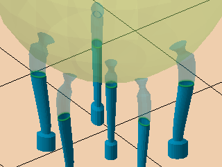

Breaking point
Generates a section where the bar narrows and widens to create a defined breaking point near the part surface, making it easier to remove supports from the part later on.
Parameter Explanation Notes
Breaking point
Toggles creation of breaking points.
Breaking point width
Defines the diameter of the bar at the breaking point.
Width on end
Determines the diameter of the bar past the breaking point where it attaches to the part surface.
Breaking point height
Determines the length of the breaking point itself.
Height on start
Determines the length over which the breaking point reduces to its narrowest point.
Height on end Determines the length over which the bar should narrow towards the breaking point, as seen from the part surface.

Pad on platform
A pad is a widened cross section at the platform end of a bar support to reinforce adhesion to the platform surface
Pad on platform
Toggles pad creation.
Pad width
Determines the width of the created pad.
Pad height
Determines the height, or thickness, of the created pad.
Pads are only generated when the whole bar's Z length is at least 2.5 times the pad height.
Taper angle ( renamed from Pad slope)
The transition from pad to bar is typically angled. This parameter makes the angle adjustable.
The taper section is included in the pad height.
