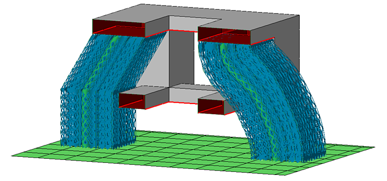

volumes and polylines are generated, you can "bend" them to avoid or specifically hit other surfaces of the same part, either by adding a knee shape ("angle") to them, or
by deforming them along a spline.
Additionally, volume and polyline supports can be projected to detected or specified upskins.
Note: Knee and spline are mutually exclusive.
Avoiding part-to-part support with a knee (left) or a spline (right)

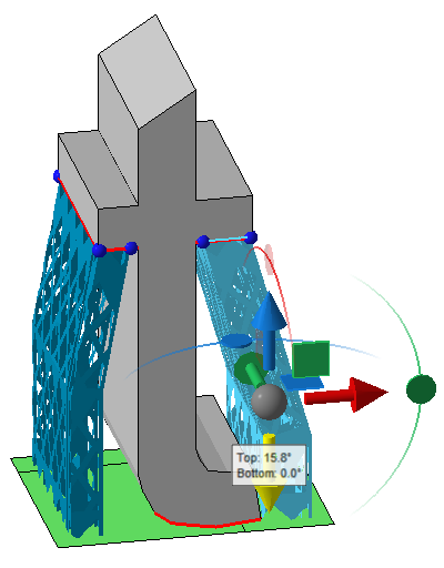

An angled knee can produce
part-to-platform and
part-to-part connections.
To activate the angled knee
- Generate the volume or polyline supports.
- Select the supports to angle and choose
Edit entity.
- Set
Angled block support to
Yes.
- Click
OK and let the support regenerate.
This spawns the angle control gizmo halfway along the overall support height, displaying the angles from the vertical for both sections, above and below the knee.
- The support's deflection
above the knee you control by dragging the gizmo's
cardinal axis arrows, planes, and center ball, simply by moving the point of the knee itself around in 3D.
below the knee you control by dragging the gizmo's
rotation arcs and the
yellow arrow representing the effective deflection.
Things to consider
- Change perspective often to verify the desired deflections in 3D.
- Moving the yellow deflection arrow is dependent on the
view angle. This can produce confusing or unexpected results when viewed at any other direction than the cardinal ones. Instead, use the viewcube or the perspective switch to look at the scene straight from the front, left, top, and so on. This way, moving the arrow is exactly the same as using the rotation arcs which offer fine control and guaranteed rotation only along the associated axis.
- Switching
Angled block support off and on
maintains the last-set angling for as long as the associated supports exist and remain known to the support editor instance.
- The only way to truly reset angling to zero is to
delete and regenerate the supports in question.

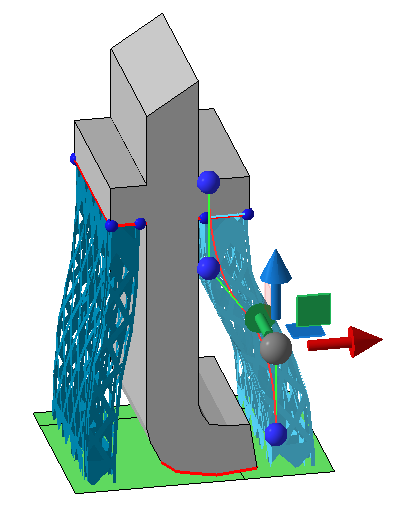

Working with the spline controls
Important: Spline deflection enforces
part-to-platform supports.
To activate the spline
Edit entity.
- Set
Along a spline to
Yes.
- Click
This draws the spline along the support, starting with four control anchors, or "basepoints".
Spline controls
- The
top basepoints is always fixed to maintain the attachment location on the part surface.
- The
bottom basepoints always moves across the platform surface.
- With the basepoints
second from top or bottom, you control the last bend each before the actual connection.
- To
move a basepoint, click on it and use the gizmo controls.
- To
add a basepoint, hover the mouse pointer towards the centerpoint between two existing basepoints and click the transparent basepoint that is auto-generated as you approach the centerpoint.
- To
delete a basepoint, right-click
Delete basepoint from its context menu, if available.
- The four initial basepoints are fixed and cannot be deleted.
- Visibility of basepoints, the green basepoint line, and the red spline is toggled in its context menu.
Things to consider
- Spline-deflected supports ignore any geometry other than their own respective downskin cluster and do not generate dedicated connections to surfaces with which they intersect on the way down.
- The only way to truly reset spline deflection to zero is to
