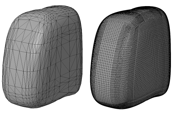

To retessellate the part for a workflow step that could benefit from a different level of mesh resolution, choose . This will provide you with a dialog to choose from tessellation presets.
The same part, tessellated with two different presets
Netfabb comes with a set of tessellation presets as well as a variant for each that includes repair. To create and modify presets, do so during retessellation, or choose .
Here, you may create and edit duplicates from the default presets (these cannot be modified). Provide a name and make your selection from these options:
