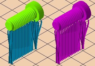

Left: Dedicated support mesh ("parametric supports") is displayed in light blue. Right: Regular-mesh supports show up in the part's (or assembly's) display color or its own actual color (not shown).
