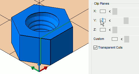

Use the clip planes to have a look at the inside of a part

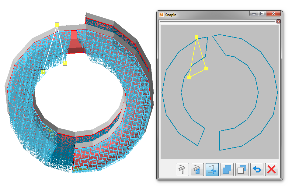

TopIn some modules, an additional view is provided temporarily. This is the snapin view, and it is used by the support module to let you edit generated volume supports in a 2D view, and by Texture & Color when aligning a texture. The snapin view is not activated and not placed by default in the Left window layout, but it appears when needed. When activated via , this view is always visible, and the modules that make use of it fill this view as necessary; otherwise the view remains as a new tab or temporary overlay in the context view.
The snapin view as it appears when editing support

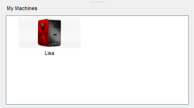

TopAny machine workspaces that you have defined in My Machines appear here. Double-click the workspace's icon to load it into the project tree.
View for picking directly from My Machines
