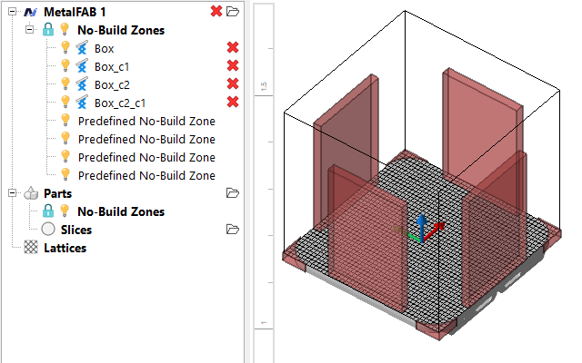

No-build zones are volumes that forbid placing any part volumes such that they intersect with them. This is enforced by preventing automated processes such as packing from claiming the space of the no-build zones and by notifying you if you cause an intersection manually.
Top
visibility icons, the menu option
, as well as using the global keyboard shortcut
Shift+N.
In this example, the zones at the corners are machine-specific, the zones along the sides are user-defined. All are listed in the project tree. The user-defined zones are also
explicitly set to be observed by the support editor.
Part platforms, including those provided by machine workspaces, have a No-build zones section in the project tree. Moving parts into such sections turns those parts into no-build zones:
Custom no-build zone entries have
context menus with commands to turn them back into parts and toggle whether the support editor should regard or ignore them.
Custom no-build zones are stored in a FABBPROJECT file, and they are also storable with a customized machine in My Machines.
In addition, some machines come with zones already defined. These zones are part of the machine workspace definition and cannot be modified.
