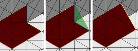

Add triangles to manually close holes or connect edges.
Add Triangles.
Left: First edge highlighted in blue. Middle: Preview of new triangle. Right: Resulting triangle.

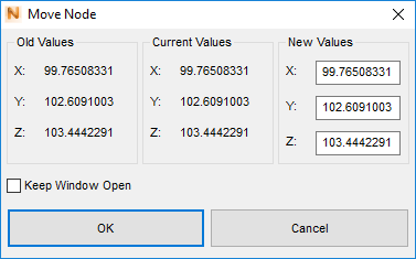

Moving nodes allows you to quickly adjust the shape and curvature of the part.
Move Node.
When clicked, a label with the X, Y, and Z coordinates of the node appears.
The coordinate label updates dynamically as you reposition the node.
