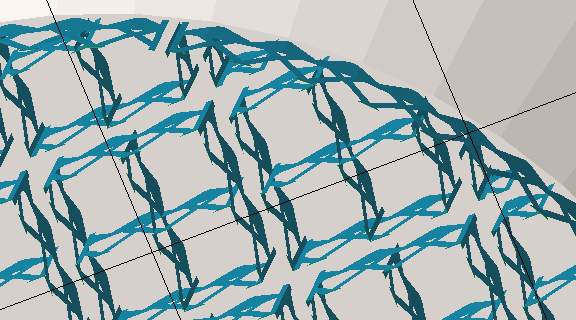

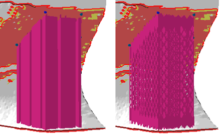

Filling Type
Switch the support walls between Closed volume (solid) and Structure.
  • The fragments that make up closed volume supports are essentially box-shaped columns. They are closed on all sides, even at top and bottom. The connection with the part surface is facilitated by small pins.
  • Structure supports are, by default, akin to patches of intersecting wire fence. Also, the entire cluster area is enclosed by a single wall along the circumference, ie. the cluster's contour.
Applied default closed-volume supports. A cut via clip plane demonstrates the cluster's contour, the fragments' cross section, the terminating surface at the top, and the stand-off against the part surface.
Applied default Structure supports. Note the gap in the circumference.

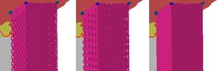

Structure pattern
Switch between Wired wall (left), a Punched plate (middle), and Plain (right) to determine the wall pattern of volume supports.

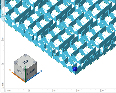

Raster
The raster is built up from intersecting polyline walls and fills the actual volume of volume support.

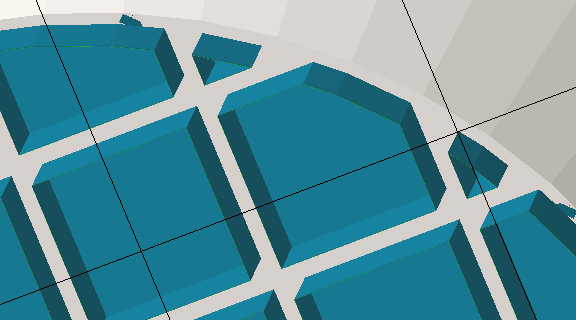

Fragments
Fragmentation of volume supports into individual blocks makes it easier to break the supports from the part.
