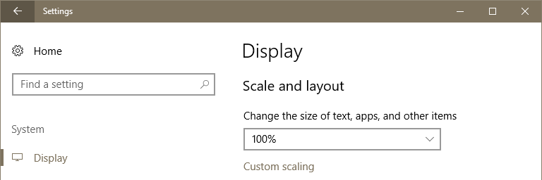

Display scaling
"My display text is too large!"
"Window elements are missing or obstructed by the task bar!"
You may have Netfabb configured to determine the font size automatically while you have Microsoft® Windows® configured to scale text beyond 100 % which can confuse Netfabb's font scaling.
Solution (use either, or both, as needed):
  • Make sure your system meets Netfabb's System requirements in terms of screen resolution.
  • Set Netfabb's font scaling manually through System > Settings > General > Font Size.
  • Adjust Windows' scaling down to 100 %:
  • There is also a per-application setting:
