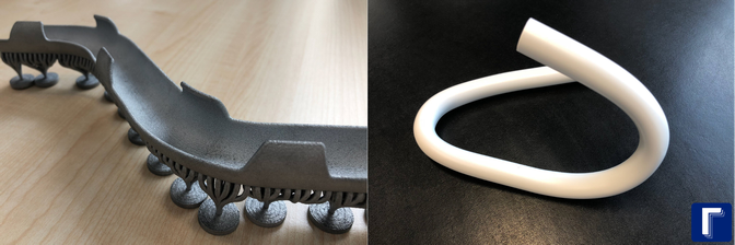

On this pipe forming tool with bar support bouquets and bottom plates, the supports remain on the part. (Part and image: Gramm UG, http://blogs.autodesk.com/netfabb/2018/09/27/gramm-story/)
