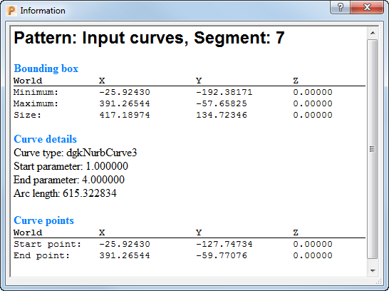

- Properties — This displays the extents, type, and key points of the Bézier curve.
Pattern — Displays the name of the pattern, in this case Input curves.
Segment — Displays the properties of this segment. In this case the seventh segment.
