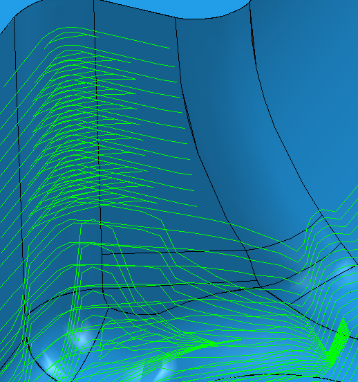

Use the Corner clearance strategy to remove material left in corners. The toolpath is generated such that the rest material is removed in successive stages, using horizontal and vertical stitch movements, or along passes.
