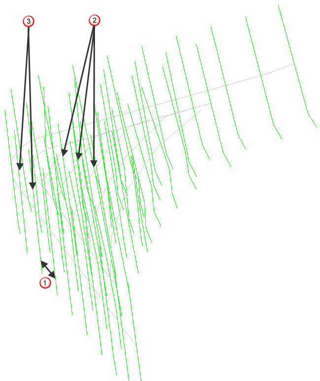

Horizontal stitches:
Steep stepover
Steep depth of cut
Steep final depth of cut

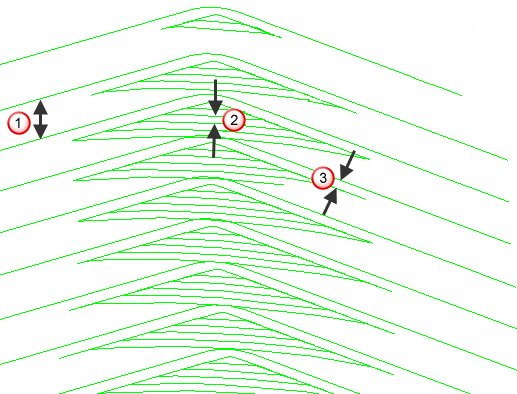

Along passes:
Steep stepover
Steep depth of cut
Along passes:
Shallow stepover
Shallow depth of cut
Shallow final depth of cut

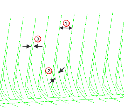

Vertical stitches:
Stepover — Enter the distance between successive machining passes.
Depth of cut — Enter the thickness of material removed by each cut.
Tolerance — Enter a value to determine how accurately the toolpath follows the contours of the model.

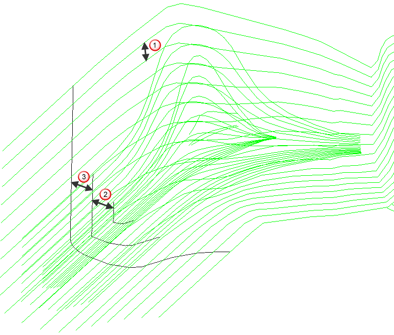

Thickness — Enter the amount of material to be left on the part. Click the
Thickness
button to separate the
Thickness
box in to
Radial thickness
Axial thickness
. Use these to specify separate
Radial and
Axial thickness as independent values. Separate
Radial and
Axial thickness values are useful for orthogonal parts. You can use independent thickness on sloping walled parts, although it is more difficult to predict the results.
Radial thickness — Enter the radial offset to the tool. When 2.5-axis or 3-axis machining, a positive value leaves material on vertical walls.
Axial thickness — Enter the offset to the tool, in the tool axis direction only. When 2.5-axis or 3-axis machining, a positive value leaves material on horizontal faces.
Component thickness — Click to display the
Component thickness
dialog, which enables you to specify the thicknesses of the different surfaces.
