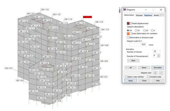

Nodal Displacement in Separate XYZ Directions
Descriptions for nodal displacement can be displayed in the separate UX, UY, and UZ directions.
To better understand and measure displacement impact in the context of given coordinate system axes, you can now assess the structural behavior in terms of displacement in separate directions or the total value. Display displacement values in a selected X,Y,Z global direction, or the total value U.
To use this:
