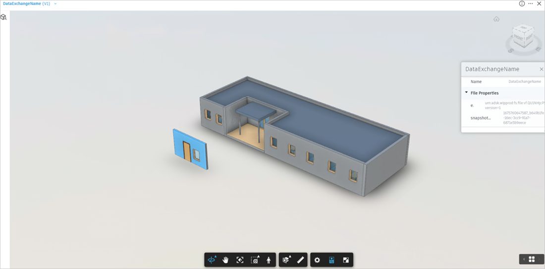

View a Data Exchange on Autodesk Docs in a browser window.
When a Data Exchange is selected for viewing you are redirected to Autodesk Docs and the Data Exchange is displayed in a browser window

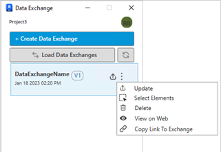

  1. Select the Data Exchange in the Connector interface. Click kebabto open the drop down menu and select View on Web.
  2. You are redirected to a new browser where the Data Exchange is displayed.
