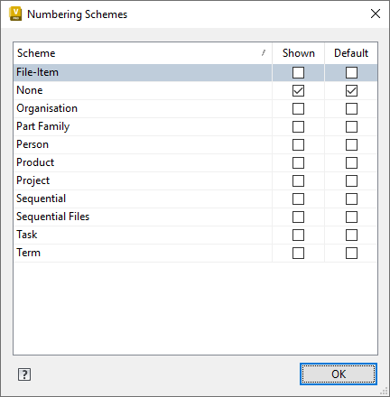

  2. In the toolbar, click Options > Numbering Scheme > Configure to open the Numbering Schemes dialog.
  3. Select the Shown check box for any numbering scheme you want to display as a view button in the Numbering Schemes Panel.
  4. Select the Default check box to set a Numbering Scheme as the default setting.
  5. Click OK.
