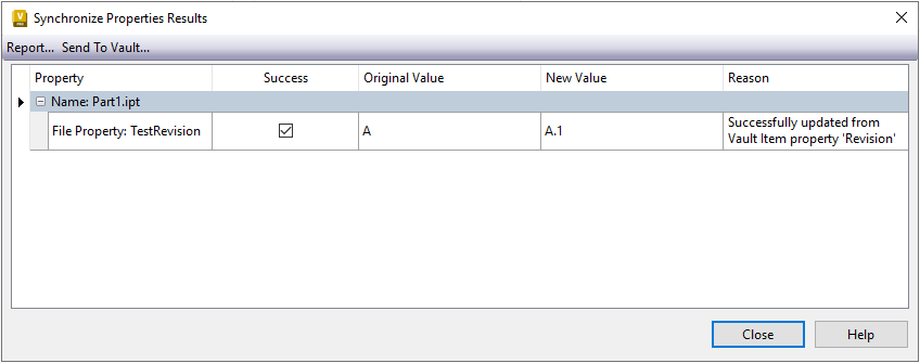

Property compliance/synchronization behavior
Vault uses the Item assigned from the Master model state to conduct a check on properties compliance and properties synchronization.
The following scenario explains the property compliance/synchronization behavior:
| Item | Name | Part Number | Assigned from File | Revision |
| Part1 | Part1 | Part1 | Part1.ipt | A |
| Part1-MS1 | Part1(Modelstate1) | Part1-MS1 | Part1.ipt | A |
| Part1-MS2 | Part1(Modelstate2) | Part1-MS2 | Part1.ipt | A |
The Inventor property (custom property) will always synchronize with Part1 item (which is assigned from the Master Model State) and thus, TestRevision will revise to Revision A.1 after synchronization. However, the file revision will remain Revision A.
