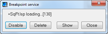

Edits the breakpoint selected in the Breakpoints dialog box.
In Visual LISP, click View
Breakpoints Window. Select a breakpoint from the Breakpoints list and click Edit.
Displays information about the breakpoint that is currently being edited. Shows the name of the source file containing the breakpoint, and the location of the breakpoint in the source. A leading + or – sign indicates if the breakpoint is enabled or disabled.
Toggles the state of the breakpoint between being enabled and disabled.
Removes the breakpoint from its associated text editor window and the Breakpoints list.
Activates the text editor window that contains the selected breakpoint, and then scrolls the text editor window to the location of the breakpoint.
Exits the Breakpoint Service dialog box and returns you to Breakpoint dialog box.
